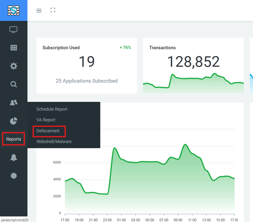

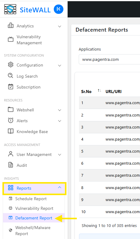

1. Login to SiteWALL Management Portal.
2. Click on Reports --> Defacement

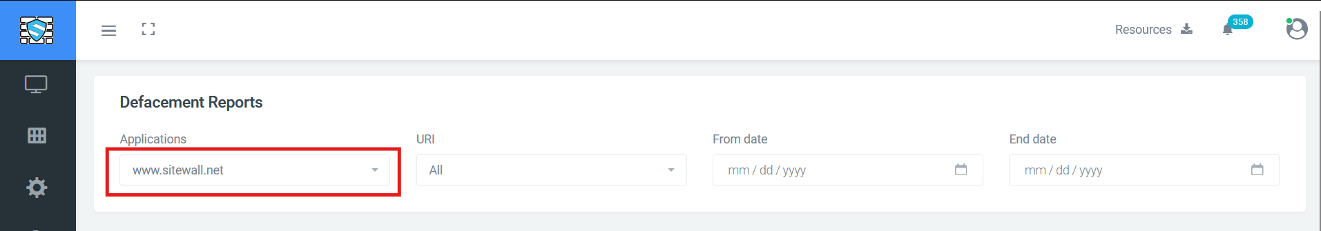

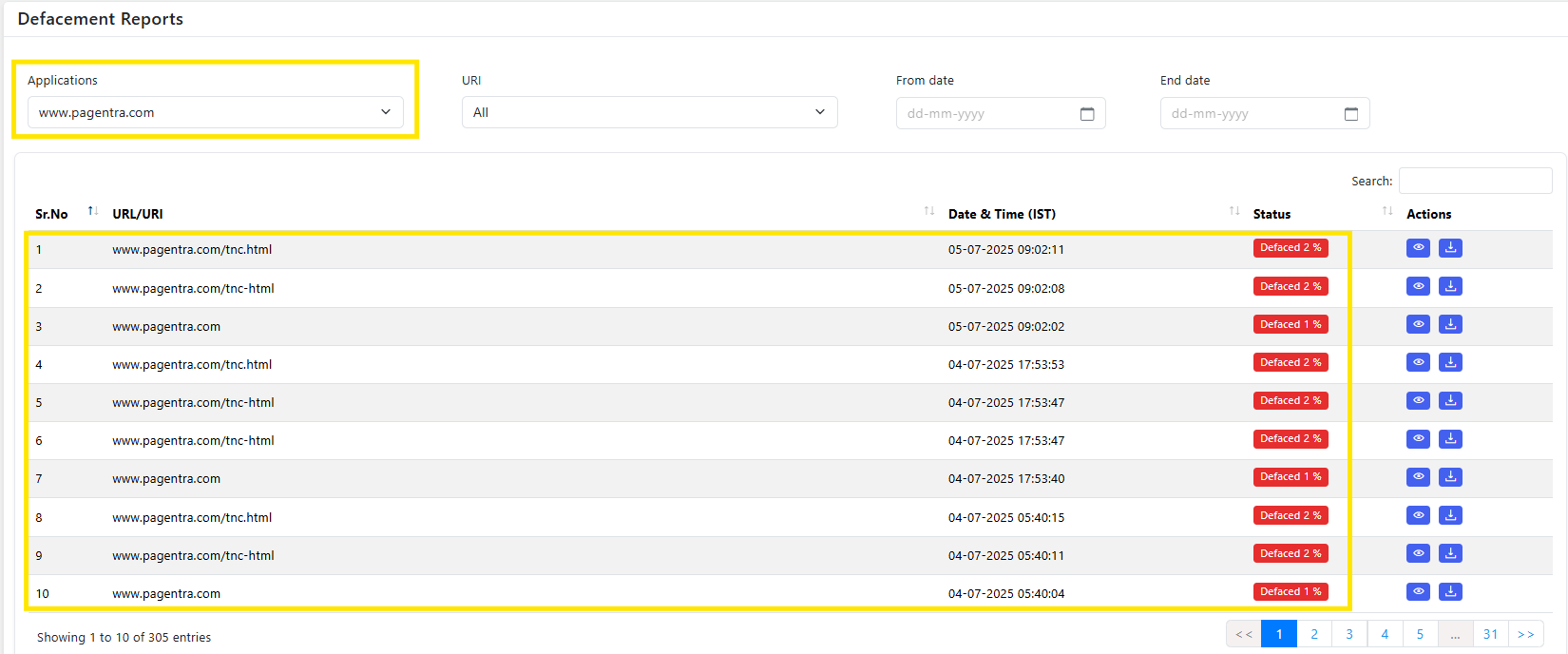

3. Select the application from the drop-down.

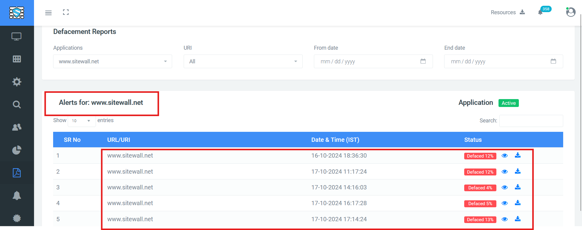

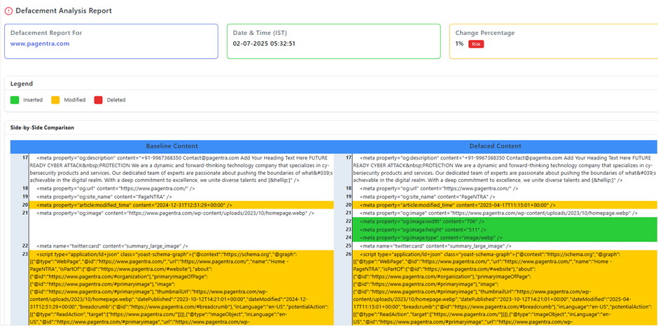

4. The Alert table will showcase all the defaced alerts for your applications along with the percentage of the content change.

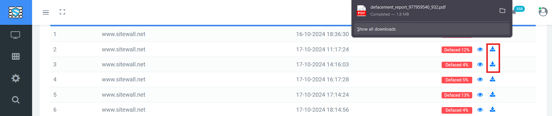

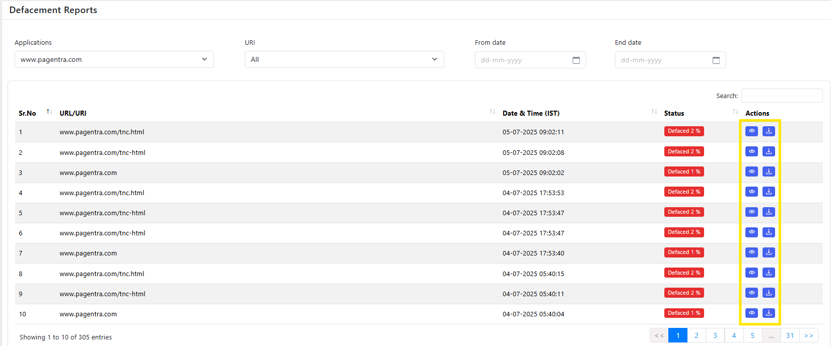

5. Click on the "Eye" or "Download" icon to view or download the report for specific alerts.
6. The alert view uses color coding to easily identify code changes in your webpage. The below table provides you the details of the color coding.
CodeDescription
Color Coding
Inserted
New content inserted in webpage.
Green
Modifed
Existing content modified in webpage.
Yellow
Deleted
Existing content deleted in webpage.
Red
